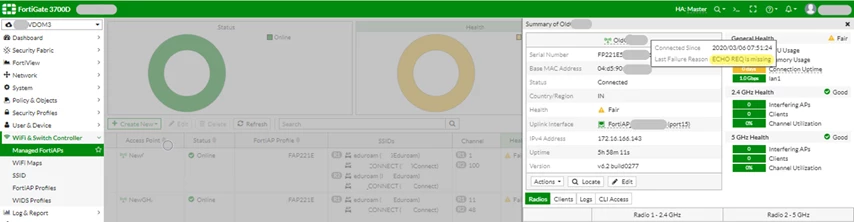

FortiAP ‘Health Status’ reasons and their screenshots.
From GUI go to Managed APs, select the required FortiAP, select 'View More Details' to view summary of FortiAP health status as shown below inline:

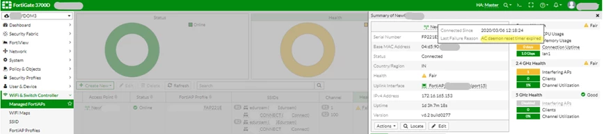

1) AC daemon reset timer expired (Fair Health).

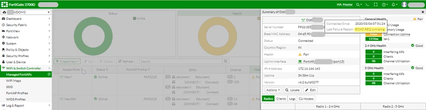

2) ECHO req is missing (Fair Health).
3) 80211 WLAN del error (Fair Health).

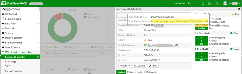

4) Control message max. re-transmission limit reached (Fair Health).
5) Connection Uptime (Fair Health).

All the above reasons are linked to FortiAP uplink connectivity/connection uptime and it implies that FortiAP connection with FortiGate is NOT stable, it is possible to incorporate below best-practices to mitigate such issues:
- Check if the Ethernet connection between FortiAP and FortiGate has any Network congestion/packet-loss/latency.
- Check if FortiAP uplink switchport is flapping or uplink Switch is rebooting/crashing or there’s STP loop in Network.
- For "ECHO req is missing" and "Control message max. re-transmission limit reached" try mitigation steps mentioned in the below KB link.
- Collect 'kp' and 'crash' command outputs from FortiAP CLI to validate if there’s any crash.
- Collect 'perf' command output from FortiAP CLI for about 5 consecutive times and check if FortiAP CPU/Memory utilization is constantly high causing FortiAP crash .
- Collect 'diagnose debug crashlog read' command output from FortiGate CLI – to verify if ‘cw_acd’ process is crashing/restarting automatically causing FortiAP connection issues.
- Check FortiAP ethernet port negotiated speed is greater than or equal to 1 Gbps speed for connection to be considered as ‘Good’. Collect 'wcfg | grep eth' or 'pbond' command outputs on FortiAP CLI to validate ethernet port speed.

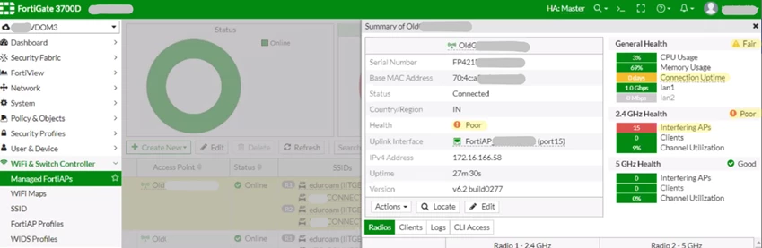

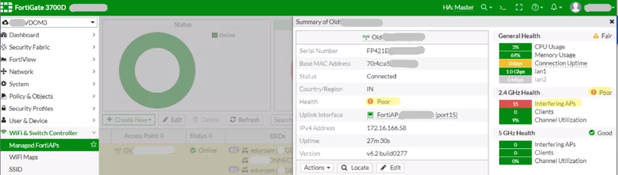

6) Interfering FortiAPs (Poor Health).
7) Channel utilization (Fair Health).

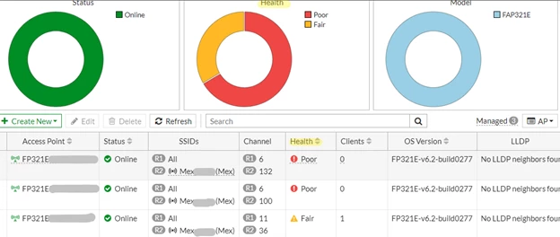

The 'Health' value of managed FAP is overall health status from 'WiFi Radios' and 'General Health':
1) Only when all health values are 'Good', the Health of managed FortiAP is 'Good'.
2) If there is at least one 'Fair' value in all, then the Health of managed FortiAP is 'Fair'.
3) If there is at least one 'Poor' value in all, then Health of managed FortiAP is 'Poor'.

Interfering FortiAPs.
0-1: Good.
1-10: Fair.
>10: Poor.
