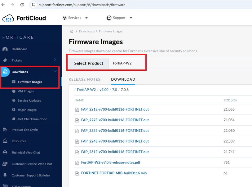

Download the required FortiAP firmware matching the intended model and release version. Login to support.fortinet.com, go to Support -> Firmware Download -> Select Product.
Specify the FortiAP product matching the FortiAP model and download the desired FortiAP firmware image to a local PC. For FortiAP-221E, the matching FortiAP product is FortiAP-W2.

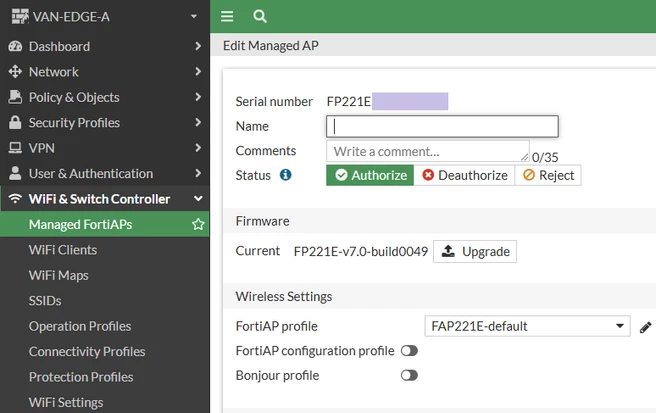

Method 1: FortiGate GUI
If FortiAP is using FortiGate as a wireless controller, the firmware can be pushed from FortiGate.

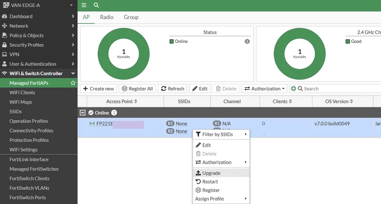

  1. Login to the FortiGate GUI, navigate to WiFi & Switch Controller -> Managed FortiAPs

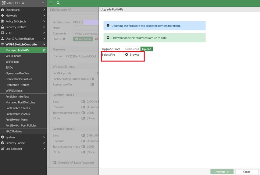

  1. Select the FortiAP unit from the list and edit it. In the Firmware section, select Upgrade.

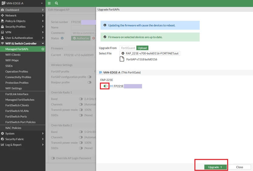

  1. Select Browse and upload the firmware upgrade file. Verify the intended FortiAPs are selected and select Upgrade.

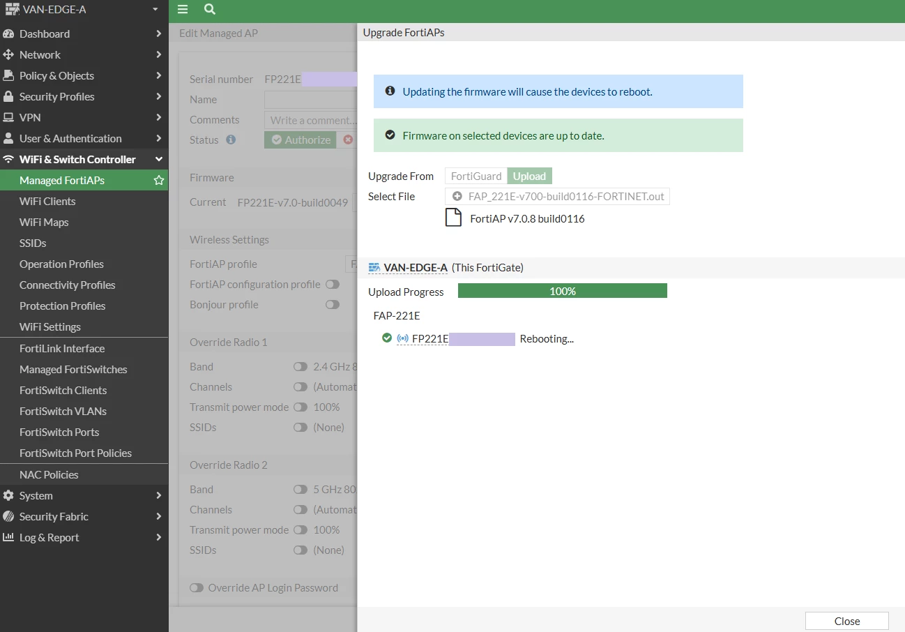

  1. FortiGate uploads the file to FortiAP. FortiAP reboots for upgrade.

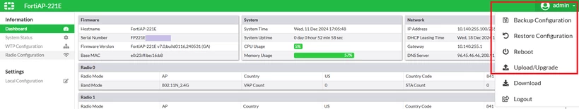

Direct Method 1: FortiAP GUI
This method is available if the FortiAP supports HTTPS administrative access.
  1. Enable HTTPS administrative access for FortiAP, see the article HTTPS and SSH administrative access for FortiAP.
  2. Login to FortiAP GUI using the FortiAP's IP address and credential. Select Upload/Upgrade from the admin dropdown.
  1. Browse to the firmware file and Select 'Upload'. FortiAP reboots to upgrade.
