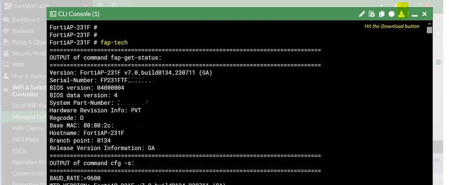

  3. 'fap-tech' command output from the FortiAP CLI access as shown below:
fap-tech  <----- Output contains details such as the FortiAP model, firmware version, SSIDs, radio settings, WiFi station stats, kernel crash, and crash records.

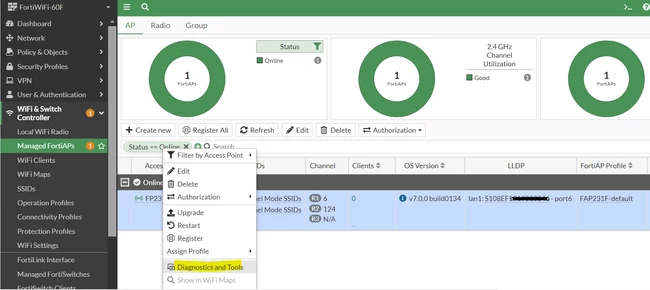

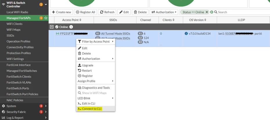

Navigate to FortiGate GUI, go under WiFi & Switch Controller -> Managed FortiAPs -> 'Right-Click' -> Connect to CLI  and type the 'fap-tech' command on the FortiAP CLI as shown below:

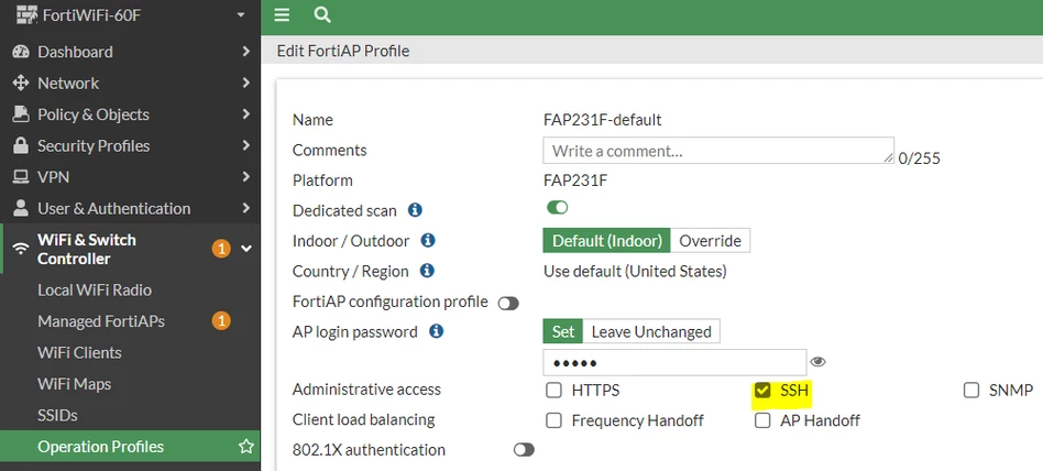

Connect to 'CLI' or 'SSH' access to the FortiAP works only when 'SSH' is enabled in the 'Operational Profiles' or 'FortiAP profile' as shown below:

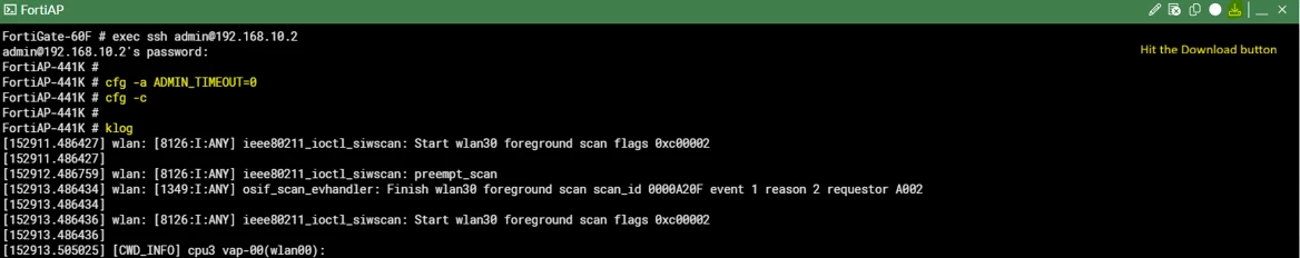

     4. Collect the 'klog' from the FortiAP using CLI/SSH access. The klog contains ARP/Authentication/DHCP logs:
cfg -a ADMIN_TIMEOUT=0
cfg -c
klog
Duplicate the WiFi connectivity issue a couple of times while the klog is running, and then stop the log using Windows 'Ctrl+C' keys.

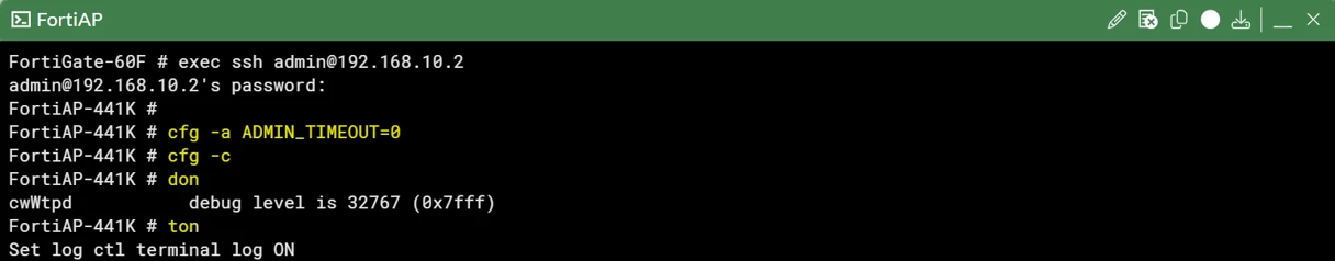

  1. Collect 'don/ton' logs from the FortiAP CLI/SSH access. The don/ton logs contain CAPWAP cwWtpd daemon logs:
    cfg -c
    don
    ton
    After collecting the logs disable the logs:
    doff
    toff

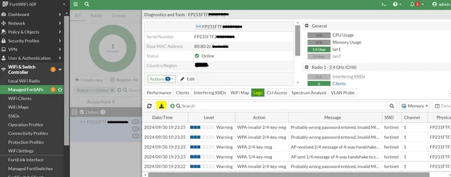

  2. Download and attach 'Logs' from the affected FortiAP by navigating to Diagnostics and Tools as shown below:

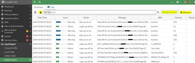

  3. Download and attach 'WiFi Events' logs from the FortiGate GUI by navigating to Logs and Report -> System Events, select WiFi Events from the drop-down menu, and select Memory to download current logs as shown below:

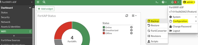

  4. Download and attach the latest FortiGate config backup to review the current wireless-controller config:

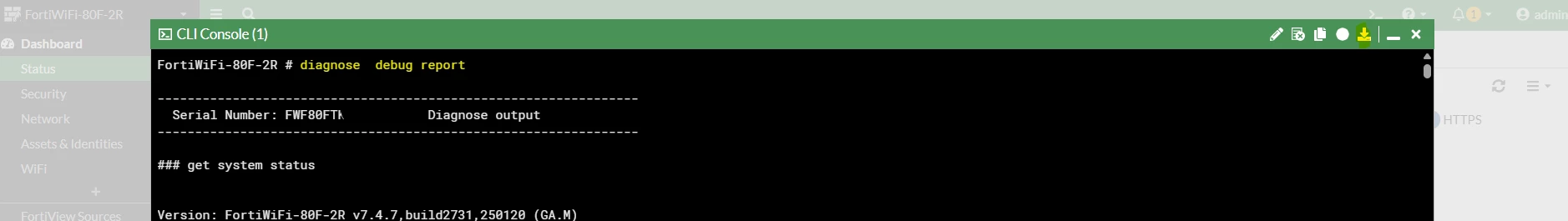

  1. Download and attach the 'diagnose debug report' output from the FortiGate CLI to check if there's any wireless-daemon cw_acd crash record, CPU/Memory usage spikes on the FortiGate:
