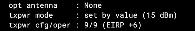

Scenario 1 - Using the supplied dipole antennas.
In this scenario, the AP has the factory-supplied dipole antennas in use, so an external antenna option is NOT required.
However, the gain of the dipoles is now considered by the FortiGate, and this is included in the target TX power setting.
The image below shows the result of this.
The optional antenna is set to None, and FortiGate knows that the default dipole antenna gain is 6dBi.
Target TX power is 15dBm set in the FortiAP profile.
Configured / operating TX power is 9dBm.
EIRP is TX power 9 + gain 6 = 15dBm target.

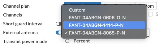

Scenario 2 – Using an external Fortinet antenna with FortiAP432F & FortiAP433F.
In the relevant FortiAP profile (remember this is only for FortiAPs with external antenna connectors), locate the External antenna radio button and enable it.
A dropdown menu will appear with all possible Fortinet antennas compatible with the specific FortiAP. Note that only the FortiAP432F and FortiAP433F have the antenna list at this time.

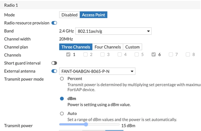

Here, choose either the correct antenna model or choose Custom for a third-party antenna. In this example, the 8065-P-N is selected. This has a gain of 8dBi on 2.4Ghz and 6.5dBi on 5Ghz.
The FortiGate now has the antenna gain and will INCLUDE this in the configured transmit power range. The FortiAP profile has a fixed TX power at 15dBm on both bands.

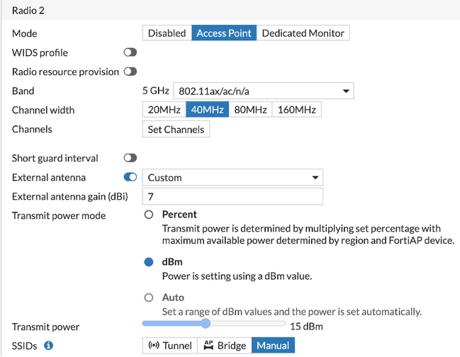

A menu will appear with the word Custom and a sub-menu with antenna gain value. At this point, refer to the antenna documentation to determine the antenna gain. It is often a different value between bands and needs to be enabled and set on each radio. Enter the manufacturer's gain value and save the profile.
The FortiAP profile will now have the manually added custom external antenna gain. In this example, 7dBi.
The target TX power is 15dBm.
