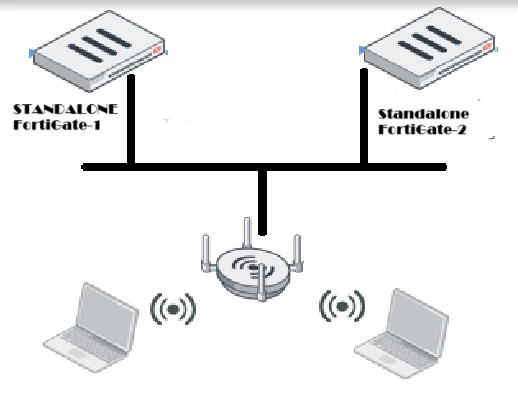

This article describes the scenario where FortiAP is managed by two FortiGate of different models operating independently.
This lets FortiAP failover to another FortiGate in a situation where the existing FortiGate goes down.
Scope All FortiAP Modes.
Consider the diagram below for reference.
  1. Both the FortiGate should be reachable to the FortiAP.
  2. Security Fabric connection to be enabled on both the FortiGate interfaces through which the FortiAP shall communicate.
  3. Configure the interface IPs of both the FortiGate. onto the FortiAP CLI
For example, there is FortiGate -1 with interface IP 10.37.165.194 and FortiGate -2 with interface IP 10.37.164.34.

This means the FortiAP will communicate with FortiGate -1 as it is set  with AC_IPADDR_1:=10.37.165.194 and if for some reason FortiGate -1 is
down then the FortiAP will attempt to reach to FortiGate -2  that is  AC_IPADDR_2:=10.37.164.34

When the FortiGate -1 becomes unreachable the FortiAP will connect to FortiGate -2.

Note: When FortiGate-1 is unreachable the FortiAP will go offline and there will be a disruption in the services for the time when FortiAP connects
to FortiGate-2.
