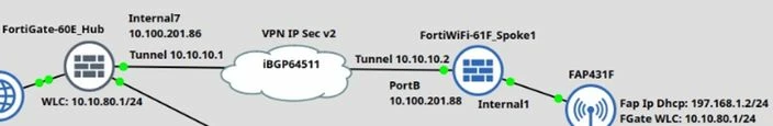

The topology comprises the following modality:
  1. iBGP peering Hub FortiGate-60F:

  1. iBGP peering FortiWiFi61F_Spoke1:

  1. Configure the VPN under FortiGate Hub Phase 1:
NGFW-2 (root) # config vpn ipsec phase1-interface
NGFW-2 (phase1-interface) # show
    edit "Hug FGate"      <----- Interface name, this one should be used for FortiWiFi-61F_Spoke1.
        set type dynamic
        set interface "internal7"    <----- Physical interface.
        set peertype any

  1. Configure the VPN under FortiWiFi61F_Spoke1 Phase 1:
FortiWiFi-61F (phase1-interface) # show
    edit "TestSpoke1"    <----- Mame.
        set interface "b"  <----- Physical interface.

        set remote-gw 10.100.201.86  <----- IP from FortiGate-60E_Hub Internal7.

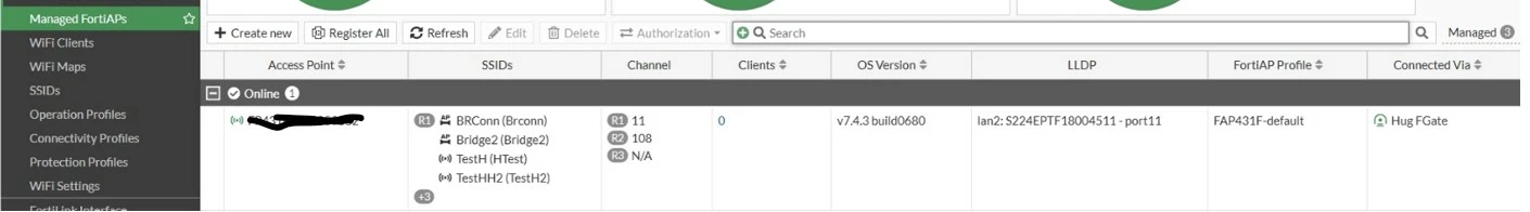

Checking VPN tunnel UP:

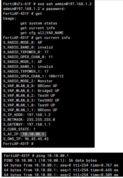

Include Firewall policies that allow the FortiAP to be online, as well as the Security Fabric activation on Tunnel 10.10.10.1 and Internal7 10.100.201.86 from FortiGate-60F.
FortiAP is connected on Internal1 under FortiWi-61F_Spoke1, 'it must not have Security Fabric activated', this interface is using segment 192.168.1.0/24, and the FortiAP is getting IP address:
This FortiAP should use 10.10.80.1 as WLC IP from FortiGate-60E_Hub and must be reachable tat hat IP address:

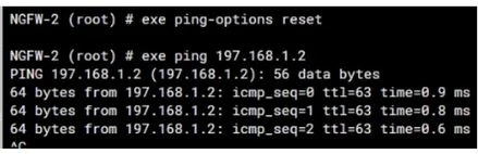

The FortiGate-60E_Hub must reach by ping the FortiAP IP address:
FortiAP is online and controlled by the FortiGate-60E_Hub, connected Via the iBGP VPN IP sec tunnel:
