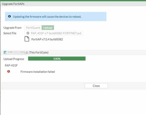

Technical Tip: 'Firmware installation failed' when upgrading FortiAP from FortiGate GUI
  • October 10, 2022
  • 3097 views
This article describes that it is possible to see the error 'Firmware installation failed' when a user is trying to update a FortiAP from FortiGate GUI.
Scope FortiAP Upgradation.
If the below error is visible, reboot the FortiAP and then try to upgrade.
