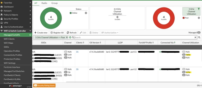

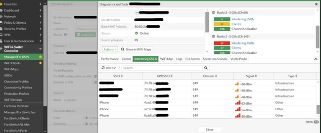

Channel Utilization is the primary indicator of Wireless Capacity on the FortiAP radio. The following factors can increase the channel utilization on the FortiAP, affecting the WiFi performance:

  1. Co-channel interference on the FortiAP is due to improper channel planning on the FortiAPs and high transmit power from neighboring FortiAPs.
  2. There is a high client load on the FortiAP radio due to poor FortiAP placements and High Transmit Power, which causes client load balancing and sticky client issues on the FortiAPs.

  8. 3rd party WiFi interface sources (E.g., WiFi hotspots/Microwave/Bluetooth/Cordless phones/Wireless cameras).
