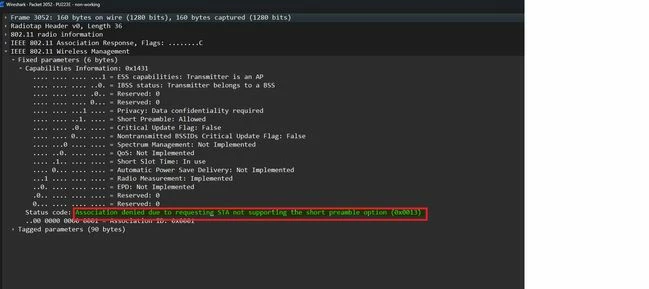

After capturing, check for Association Response packets from the AP that indicate 'Association denied because the requesting STA does not support the short preamble', as shown below:
If the captures match the above, collect another set of OTA captures along with the klog from the FortiAP, as well as a backup from the FortiGate, and submit a ticket to the Fortinet Technical Support Team.
