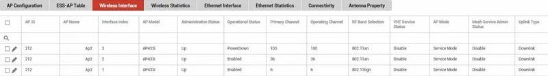

This article explains why the 3rd interface operation status shows "power down" on the AP433i Access Point.
This scenario is illustrated below with the AP433i powered with 802.3af and only 2 radio interfaces (2x2) having come up.
To bring up 3 radio interface (3x3) it is necessary to provide 802.3at (IEEE Std 802.3at-complied PoE sources).  Providing 802.3at power brings up all three radio interface of the AP433i.
