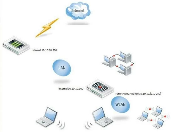

Network diagram:
-The FortiGate internal interface has the address 10.10.10.200 configured within the 10.10.10.0/24 subnet.
-The FortiGate has a VAP interface for the wireless network configured with SSID and DHCP server.
-The FortiGate DHCP server range is 10.10.10.[210-250]
-The FortiAP has an interface with the address 10.10.10.100 within the 10.10.10.0/24 subnet.
The WiFi Clients detect the FortiAP and retrieve an IP address to connect to the network.
The WLAN users cannot reach the wired network with the below configuration:
