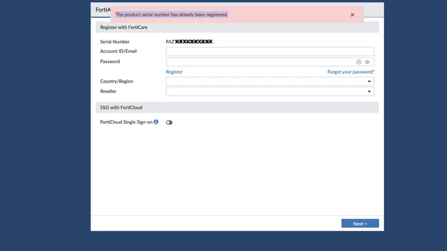

This article describes how to resolve an issue while setting up FortiManager/FortiAnalyzer where, during login, the user is prompted to register even though the user has already registered on the Support Portal. Trying to register again results in the error:
The product serial number has already been registered

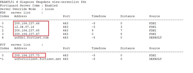

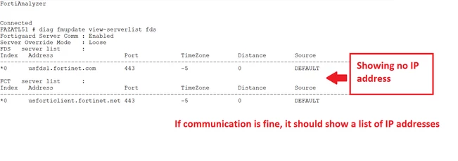

  1. Check if the FortiManager/FortiAnalyzer is getting the FortiGuard server's IP address:
diagnose fmupdate view-serverlist fds

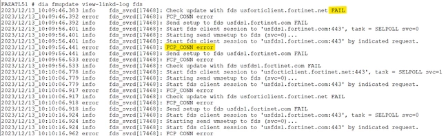

  1. Check the FDS logs:
diagnose fmupdate view-linkd-log fds
Logs for an FDS connection error:

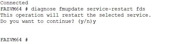

  1. Restart the FDS service from the FortiManager/FortiAnalyzer CLI:
diagnose fmupdate service-restart fds
  1. Check the FortiGuard server's IP address again. It should show multiple IP addresses:

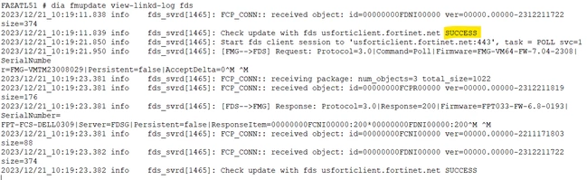

  1. Check the FDS logs again. This time the communication should be successful:
