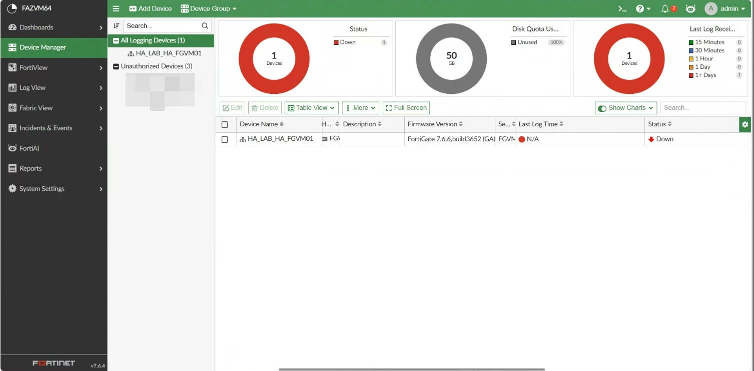

When FortiGate is replaced for RMA, the Serial Number will be changed. When the Serial Number of FortiGate has been changed, FortiAnalyzer will not be able to recognize the FortiGate and the status will show 'Red'.
Rather than integrate New FortiGate (via RMA) with FortiAnalyzer, it is better to change the FortiGate old Serial Number to the New Serial Number. This setting can be performed via CLI, and the command is:

Then the GUI will show that the FortiAnalyzer has been authorized and the status FortiGate will show 'UP'.
