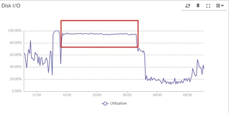

  1. High I/O disk usage:

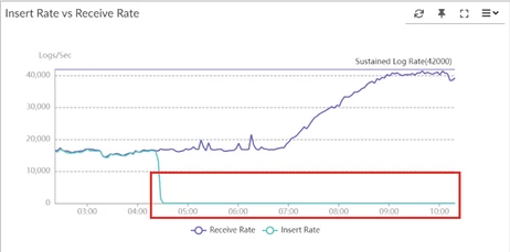

  1. Low or zero insert rate, despite normal values of the receive rate:
This behavior is expected and is due to the upgrade of the log tables structure, which can last from several minutes to several hours, depending on the Log Database size.

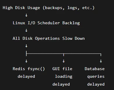

When the IOwait spikes, it will cause all the FortiAnalyzer functionalities to delay, such as GUI loading.
To fix the issue, ensure the logs respect the configured ADOM storage ratio (default 70%: 30%).
Then delete the old logs when they reach 90%.
If FortiAnalyzer disk is in normal condition but IOwait% still spikes, it is recommended to run the diagnose system fsck harddisk (to repair and check the health disk). Note that the command will force the device to reboot.
