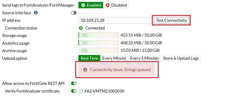

  2. Select Test connectivity to check the connection status, logs will be queued as below:

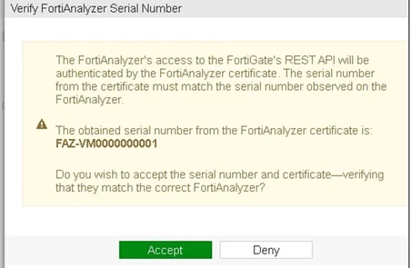

  3. Upon selecting Apply in the same page, the following Notification message may appear:

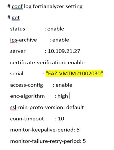

  4. Validate that the FortiAnalyzer Serial number on the FortiGate is not the Trial Serial[FAZ-VM0000000001] as below:
Note: In some scenarios, the output of the command above may show the serial of FortiAnalyzer as 'FAZ-VM000000001'

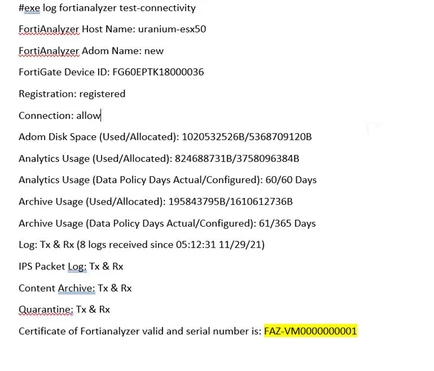

  1. Test the connectivity from FortiGate to FortiAnalyzer and notice that the FortiAnalyzer serial number will appear as FAZ-VM0000000001.
  1. This indicates that the FortiAnalyzer serial number in the Local certificates of FortiAnalyzer isn’t matching the actual FortiAnalyzer Serial number

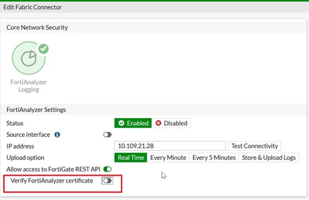

      • Disable the Certificate Verification on FortiGate either through the CLI or the GUI.
In the CLI:
In the GUI:

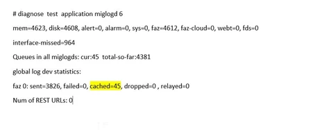

Check the Cached logs before and after applying the license as below:
