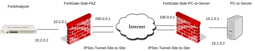

This article describes a FortiAnalyzer unit which is located on a different site than the FortiGate unit. The task is to send logs from the FortiGate unit, located at one site, to a FortiAnalyzer unit, located at another site, as described in the diagram below:
FortiGate, FortiAnalyzer.
The solution to this requirement is to send the FortiGate-Side-PC-or-Server logs to the FortiAnalyzer unit via an IPsec tunnel.
However, in some cases, the FortiGate-Side-PC-or-Server unit may be unable to send logs to the FortiAnalyzer unit on the other site, because the FortiGate-Side-FortiAnalyzer firewall on the other site may drop the log traffic.
To fix this issue, it may be necessary to specify the source IP address on the FortiGate-Side-PC-or-Server unit, which sends the logs to the FortiAnalyzer unit at the other site. This source IP would typically be from the private IP subnet scope, which is configured on the inside or internal LAN, network interface.

Once the above CLI command is configured, the FortiGate-side PC or server will use the source IP address 10.1.0.1 to send logs. The log traffic will then be routed through the IPsec tunnel from the internal network of one site (the PC or server site) to the internal network of the other site, where the FortiAnalyzer unit is located.
