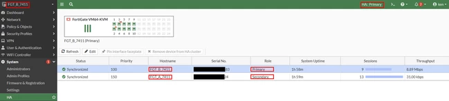

After FortiGate HA failover:
FGT_B (Primary role), Serial Number ended with ...83.
FGT_A (Secondary role), Serial Number ended with ...24.

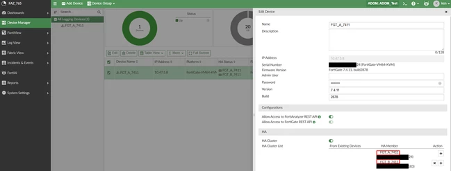

At FortiAnalyzer's Device Manager, it does not have FortiGate HA role information. When FortiGate performs any failover action, FortiAnalyzer will only show FortiGate Name and FortiGate Serial Number.

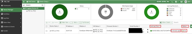

At FortiAnalyzer, go to Device Manager -> Last Log Time status shows (0 minutes ago), it mean FortiAnalyzer continuously receives logs from FortiGate.

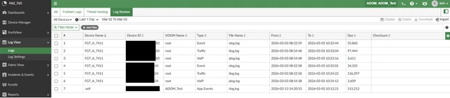

At FortiAnalyzer, go to Log View -> Logs -> Log Browse -> It is possible to show both FortiGate (Primary and Secondary) HA's Serial Number.
