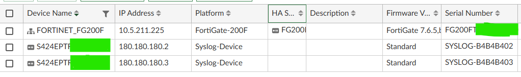

Two syslog device type will appear as unauthorized devices with their own Fortilink IP addresses.
They are authorized and Device Name is assigned to them:
The derived Serial Number is the dotted decimal representation of the IP Address of each FortiSwitch, e.g.:
180.180.180.2 = B4B4B402

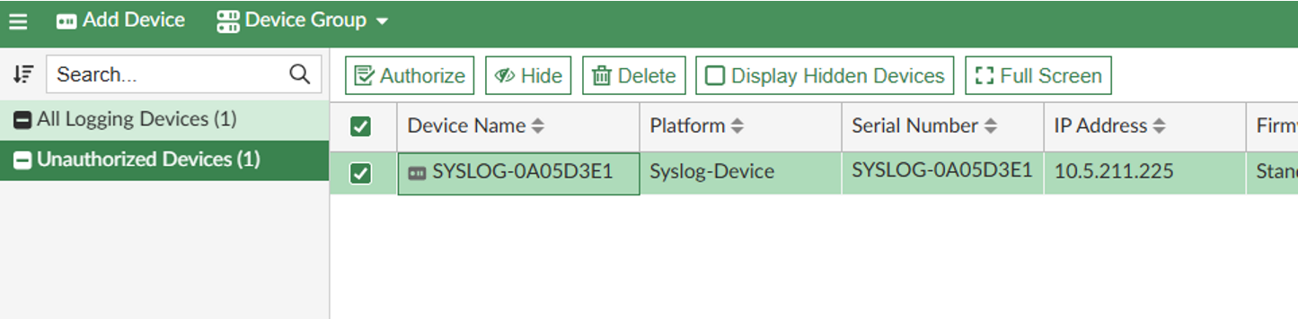

Now only one entry will appear as Syslog-Device, that is due to the fact that Fortilink IP addresses are being translated to a FortiGate Port1 IP address.
Since the decimal conversion is done for the Serial Number 0A05D3E1 which equals 10.5.211.225, only one entry is effectively registered.

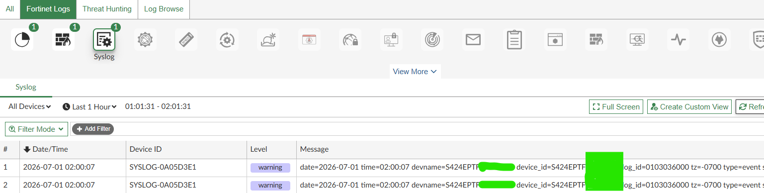

Although it is important to take into account that all syslog logs from both FortiSwitches will still be received under Logs -> Fortinet Logs -> Syslog.
However all logs will be stored with the given Device Name. The device_id that is the real Serial Number of each FortiSwitch will still be contained in the logs:
