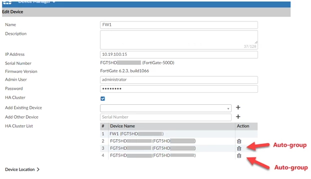

When there are multiple FortiGate(s) HA cluster are sending logs to the FortiAnalyzer, a consideration should be taken on the config attributes from the FortiGate to be auto group under the same unitname.
Take the following as an example where FortiGate#3 and FortiGate#4 which are being auto group under the same device name 'FW1'.
Even though, it is deleted from the unit , it will then again keeps added under the same device repeatedly if the FortiGate(s) end are sending the log.
To mitigate such issue, it is possible to disable HA auto grouping under the system global from the CLI as follows, it is enabled by default.
When criteria of FortiGate HA Group Name + First 6 prefix of the FortiGate Serial Number are the same, all of the FortiGate will be auto group under a single HA cluster unit.
For example, the following FortiGate#3 and FortiGate#4 will then auto group into the existing unit if the criteria are matched.
# config system global
set ha-member-auto-grouping disable
