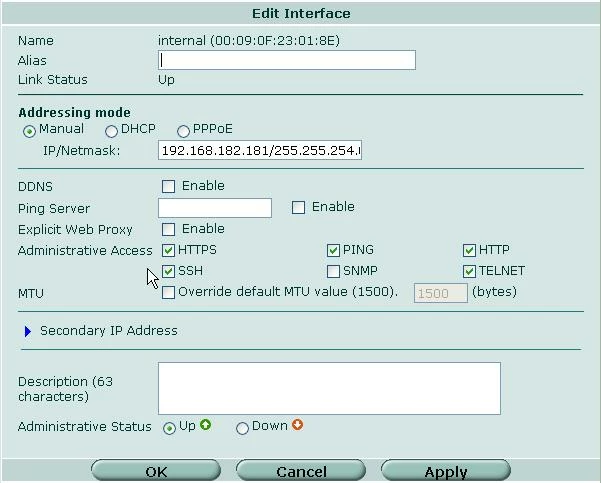

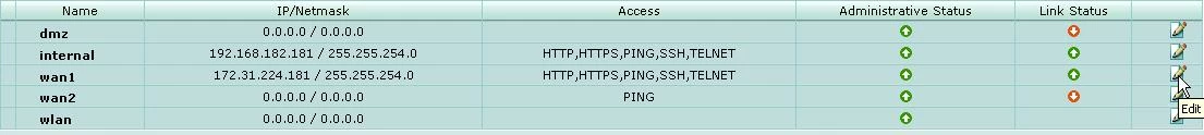

1) Configure remote management access in the network interface options page of the Fortigate, FortiAnalyzer or FortiManager GUI System --> Network
Editing the interface that connects the hardware to the Internet.
2) Edit the interface and activate SSH and HTTPS, the most secure options for management access to the device.

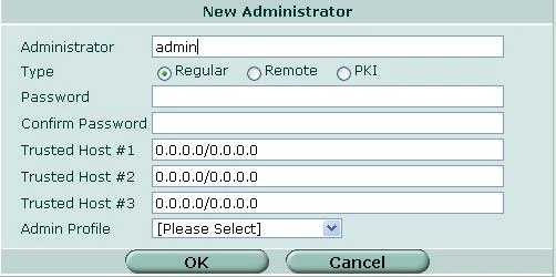

Create an administrative account for the Support Engineer.
3) To add a admin account, go to System --> Admin and selecting Create New.
4) With the public IP the Support engineer is using, define a trusted host for this account.

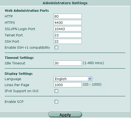

If a port forward VIP using HTTPS or port 443 is in use, change the default HTTPS management port to another that is not in use.
This option is only available in FortiOS 3.0 and above by going to System --> Admin --> Settings.
Once changed, HTTPS access to the FortiGate web-based manager is managed with a colon and the new port. For example - https://192.168.1.99:4430.
