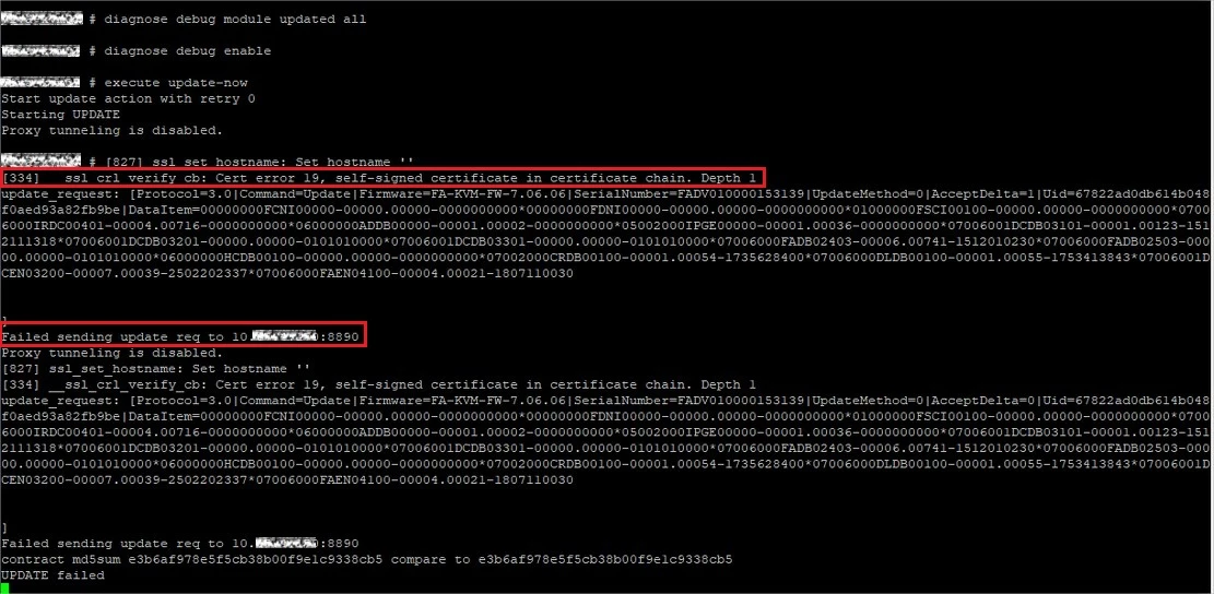

  1. In this scenario, FortiADC failed to connect to FortiManager as the FDS service for license validation and package update downloads. This issue happens after upgrading the FortiADC firmware to v7.6.6. Run the debug command to troubleshoot the update service, which shows that the FortiADC failed to connect to the FortiManager with a certificate error.
Debug commands for 'updated' service:
diagnose debug module updated all
diagnose debug enable
execute update-now

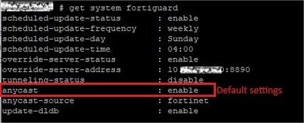

  1. Check and confirm if the FortiADC CLI configuration shows the default value for 'FortiGuard anycast' settings.
Command to get FortiGuard config:
get system fortiguard

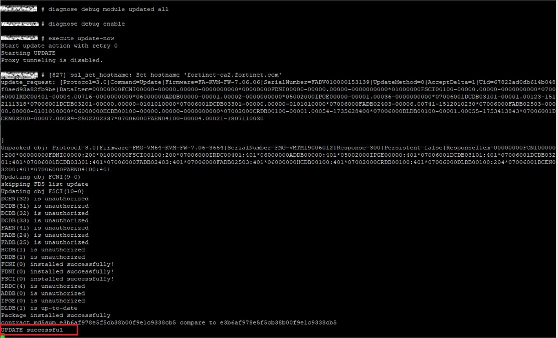

  1. Rerun the debug commands and trigger the FortiGuard update from the FortiADC. The debug output shall show that FortiADC has successfully updated from FortiManager.
