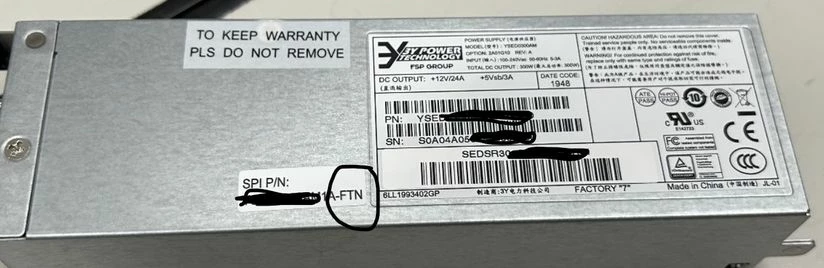

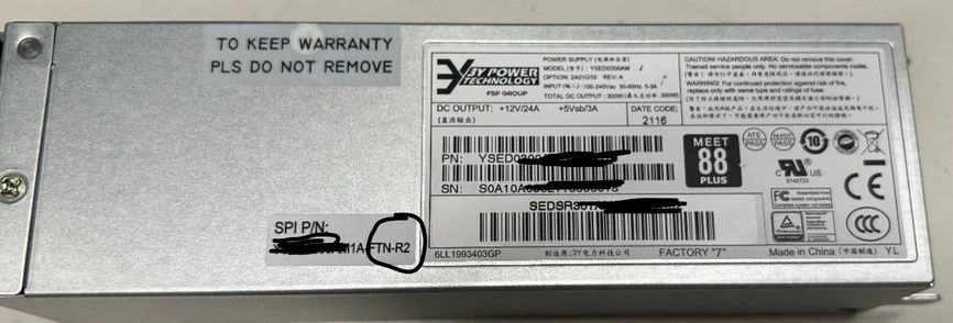

It is identified that some PSU models for FortiADC can generate such errors. Remove the PSU from the FortiADC fan slot (which is hot-swappable) and look for the P/N number:
  • If the PSU P/N end with FTN without '-R2', RMA the PSU:
If the PSU P/N ends with FTN-R2, it is the new version and should work normally.
