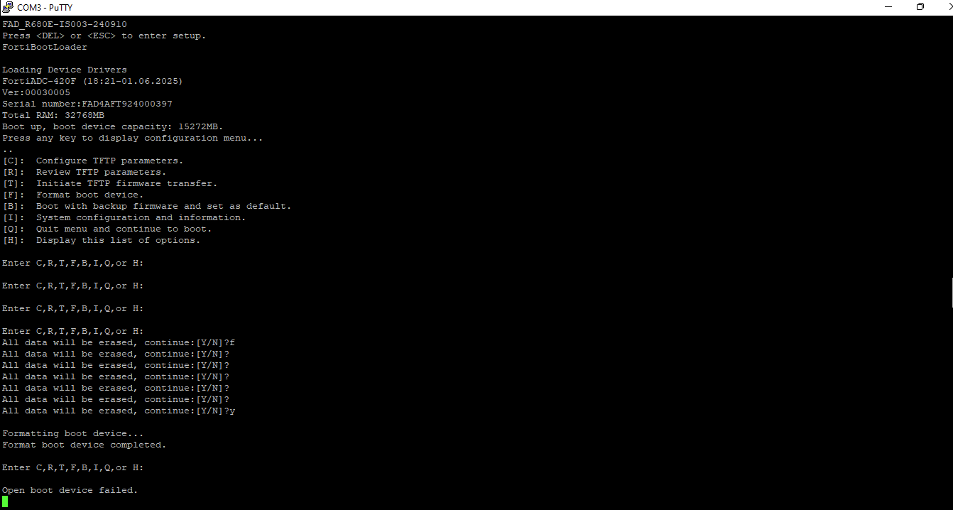

This article describes how to resolve the 'Open boot device failed' error on FortiADC.".
FortiADC.
Step 1:
  • Reboot the FortiADC.
  • Press any key while being promoted with (Press any key to display configuration menu...).
  • Press F to format boot device. Then press B [Boot with backup firmware and set as default].
  • If the issue persisted with the same error, 'Open boot device failed', then proceed with step 2.
Step 2:
  • Connect FortiADC to a TFTP server and upload the firmware image to the TFTP server.
  • From the configuration menu (reboot, then press any key to display the configuration menu), press T (Initiate TFTP firmware transfer).
