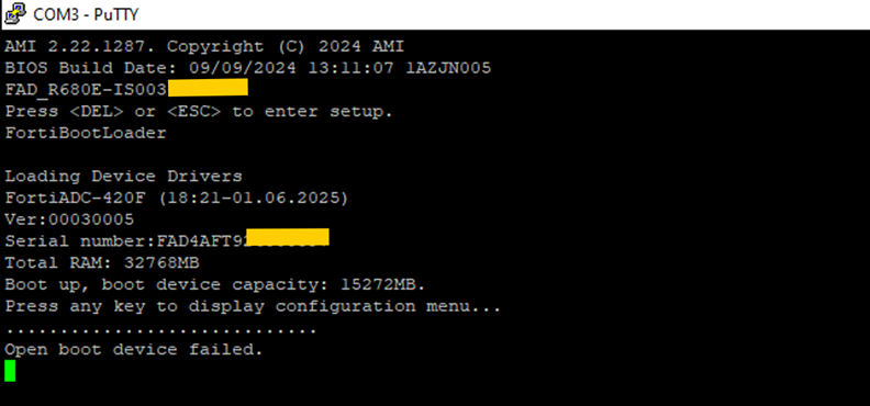

Technical Tip: Resolving 'Open boot device failed' error on FortiADC
This article describes the cause and resolution for the error “Open boot device failed” observed during the FortiADC boot process.
FortiADC and Hardware Appliances.
  1. Problem Explanation.
This error occurs when the FortiBootLoader is unable to read a valid system image from the internal storage device (SSD/eMMC), preventing the appliance from loading the operating system. This condition is typically associated with:
  • Corrupted or missing factory image on new hardware.
  • Damaged or unreadable boot partition.
  • Interrupted or incomplete storage initialization.
Follow the steps of Restoring firmware (“clean install”) via TFTP to restore the device.
Example of console error below:
