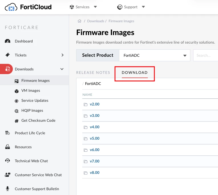

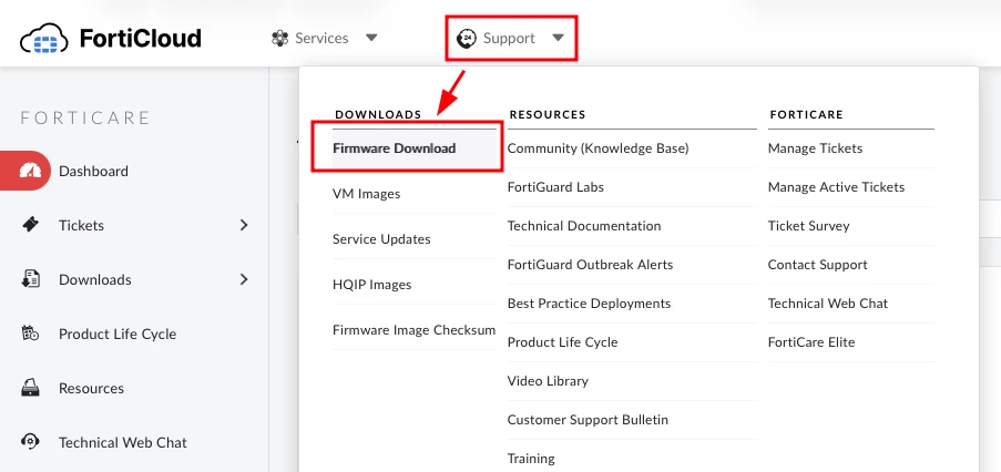

Log in to the Customer Service & Support web portal, and select the 'Download' option, followed by 'Firmware Images'.

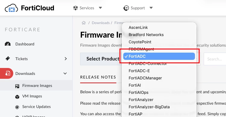

Select 'FortiADC' from the product selection dropdown list.
Select 'Download' to get the available firmware list.

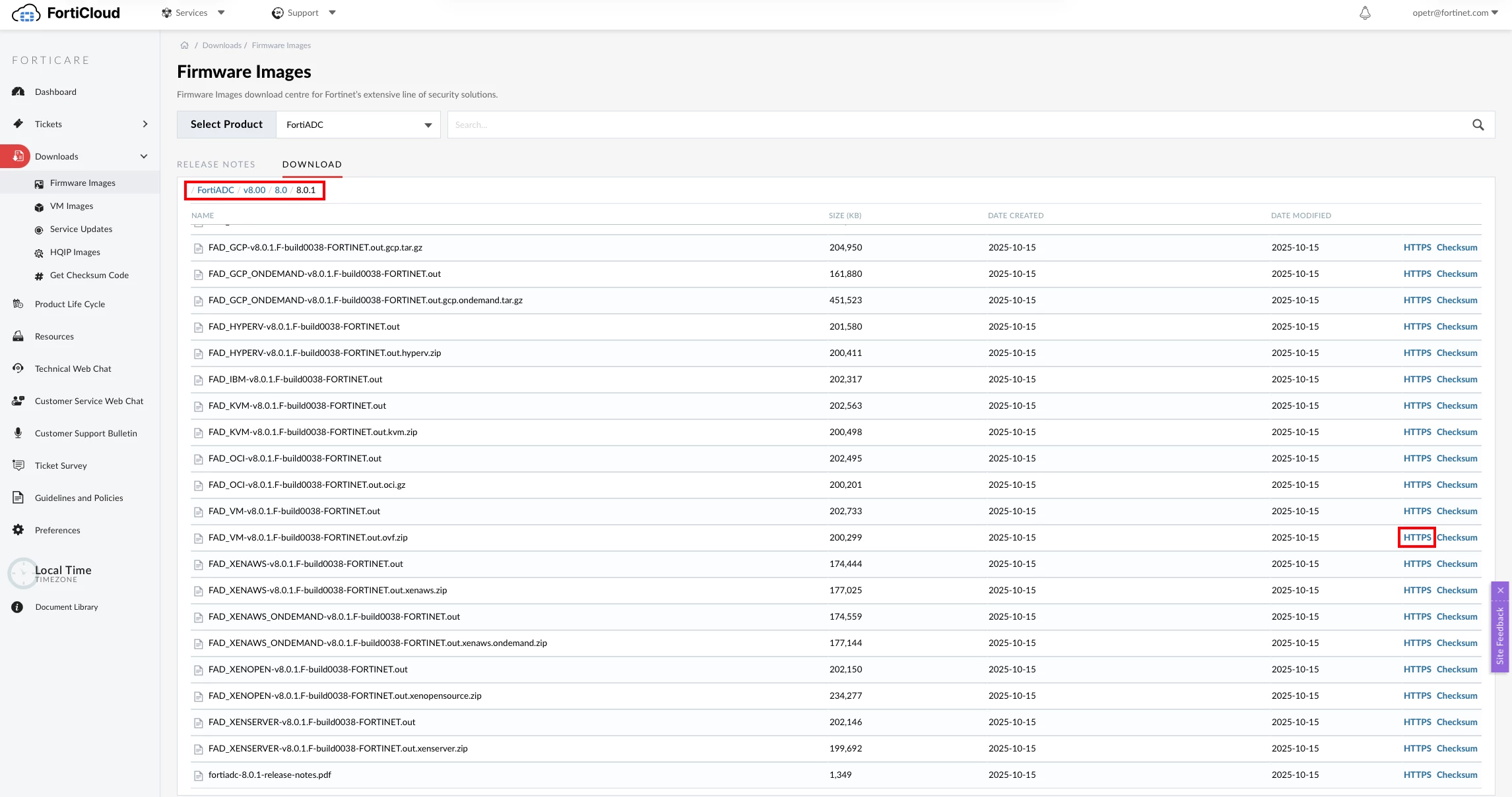

Select the respective firmware version required, and select 'HTTPS' to start download.

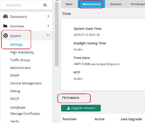

Browse to the path below. Go to System -> Settings -> Maintenance -> Firmware.

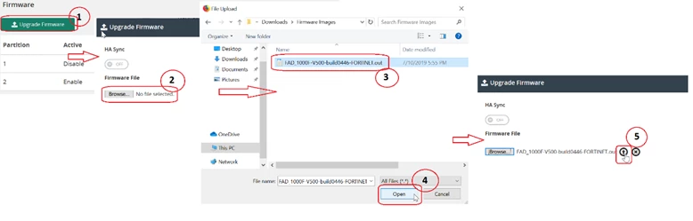

Select Upgrade Firmware to start the upgrade procedure.
  • Select the Upgrade Firmware button.
  • Select the Browse... button to bring up the file window.
  • Select the firmware image file.
  • Select Open to select the respective firmware image file.
  • Select the Upload button to start the upgrade procedure.
