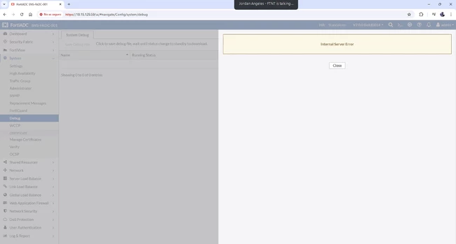

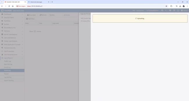

When disks are not mounted properly in FortiADC (Physical Appliance or VM), the FortiADC is not able to be upgraded or generate the 'all-in-one' (System Debug File), displaying errors like the next one:
Use the output of the command 'diagnose hardware get sysinfo df' to display disk-free information.
