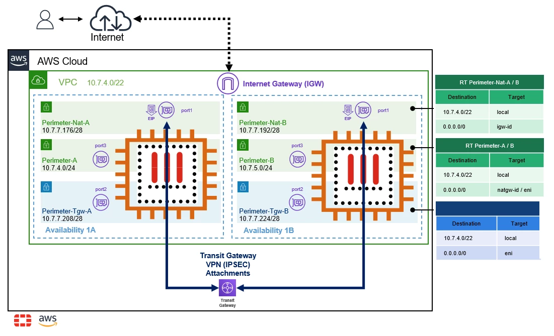

This version of the Landing Zone Accelerator on AWS (LZA) uses FortiGate firewalls to implement network security by segmenting and separating communications in the AWS environment using best practices sample configurations.
It will automatically deploy the FortiGate EC2 instances as part of the deployment pipeline.  The FortiGate instances are deployed in an Active-Active architecture connected to an AWS Transit Gateway via VPN (IPSEC) attachments and BGP routes exchange. The FortiGate architecture is as it was deployed in the AWS Secure Environment Accelerator, the predecessor of the Landing Zone Accelerator.
This is accomplished by having the FortiGate instances bootstrapped (cloud-init/user data) with their respective configuration files. These configuration files contain the routing configuration as well as sample security policies best practices.   An online version of these config files can be found at the following links:
